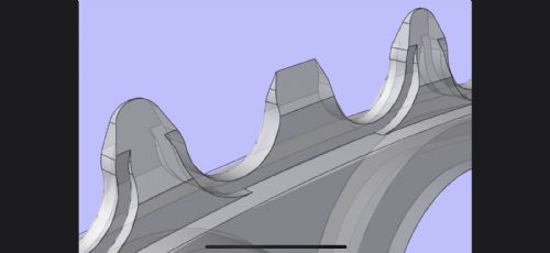

Post Options Post Options   Thanks (0) Thanks(0)   Quote RoyMacdonald Quote  Post ReplyReply Direct Link To This Post Posted: 26 August 2023 at 5:38pm
Here is Daniel Fenn's latest chainring.
Smile
< id="BFI_" style="width: 1px; height: 1px; display: none;">
Edited by RoyMacdonald - 26 August 2023 at 5:41pm
