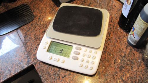

Post Options Post Options   Thanks (0) Thanks(0)   Quote RoyMacdonald Quote  Post ReplyReply Direct Link To This Post Posted: 12 September 2020 at 9:48pm
Thanks Kim, brilliant.
What was the replacement access cover in ABS reading?
Was it the same as my race number plate I labeled control?
Edited by RoyMacdonald - 12 September 2020 at 10:16pm
Post Options Post Options   Thanks (0) Thanks(0)   Quote RoyMacdonald Quote  Post ReplyReply Direct Link To This Post Posted: 12 September 2020 at 10:02pm
ABS replacement cover 18 grams
Original carbon fiber access panel 14 grams.
Thanks for the new tags Kim.
Edited by RoyMacdonald - 12 September 2020 at 10:17pm
