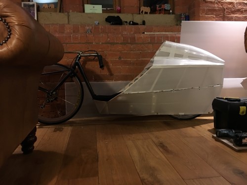

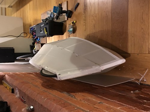

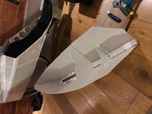

Post Options Post Options   Thanks (0) Thanks(0)   Quote russellbridge Quote  Post ReplyReply Direct Link To This Post Posted: 21 February 2016 at 8:09pm
A few more photos showing the bottom bit of the fairing now in place - just needs a run of duct tape around the join. I can pump the tyre up through the hole where my head goes, so I should only have to remove the lower half of the fairing if I get a p*ncture...
Still waiting for it to stop raining so that I can take it for test ride...I'm gonna be building an ark next...
It looks quite tall, but hopefully it's just 'compact'. I'll take a photo in the daylight and do an overlay against the Nocom and a Ratracer.
ps I've gone for a standard brake lever until I get used to the bike, but I've got a spare 'Rocket' gripshift to test as a brake actuator if I'm feeling brave...

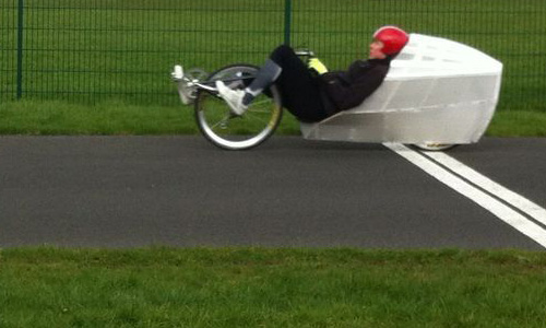

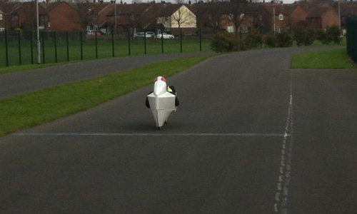

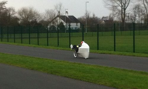

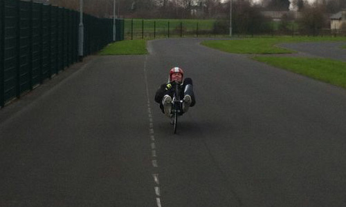

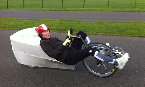

Post Options Post Options   Thanks (0) Thanks(0)   Quote russellbridge Quote  Post ReplyReply Direct Link To This Post Posted: 28 February 2016 at 9:13pm
Some almost finished photos below, and a video hopefully, if I can work out how to embed it:
It feels quite twitchy as if it wants to spit me off, mostly around the corners.  Having said that, it is a few weeks since I last rode it, and I got more stable for the hour I was at the track.  Unfortunately I won't be at Hillingdon as I'm doing the Tour of Flanders - Hillingdon would have been a great place to test it against the Nocom.  Lancaster is going to be a proper baptism of fire - very fast corners that require constant pedalling and a steady tiller. Neither of which I appear to be able to do on this yet... :)
ps in case you can't tell from my ruddy complexion and natty attire, it was bl00dy cold!  Many thanks to Ms B for patiently taking photos and putting up with correx sheets littering the house...
