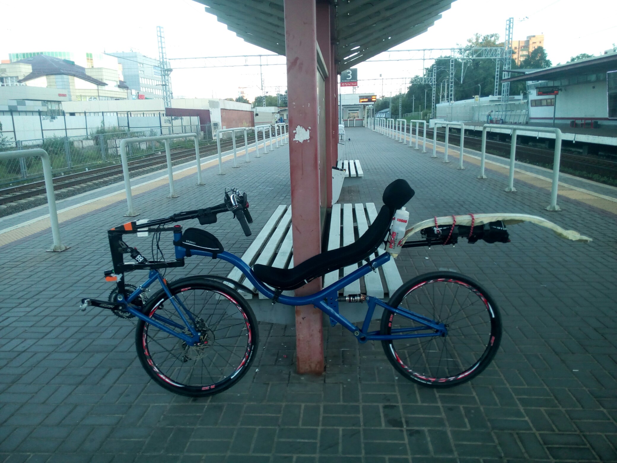

Post Options Post Options   Thanks (0) Thanks(0)   Quote Balor Quote  Post ReplyReply Direct Link To This Post Posted: 29 June 2018 at 10:11pm
Maiden voyage!
https://www.strava.com/activities/1670046779
[IMG]
I daresay it is fast enough for a FS bent with body position (low BB) and crank length I'm not familiar with yet.
"Cruzbike cockpit' with 'seagull bars' is great and short cranks allow for comfortable arms position without my knees hitting anything in the process.
I should note that road on that track is very bad, with lots of potholes and rough, weathered asphalt.  Funny enough, front suspension seems much 'smoother' than the rear - likely due to heavy front weight bias (hence much larger suspended mass) and rearward axle path.
Among 3 MBB bents I've tested (Zorkra Clone, MBB with negative angle and this one) - this is the most easily steered bike, despite front triangle weighting a ton. One-handed operation is trivial, riding no-hands is ALMOST doable even for an oaf like me! I bet I'll get the hang of it eventually.
Basically, ride has a 'relaxing' quality that my previous MBB bents sorely lacked. You don't feel like being from one small hand twitch from lying in a ditch :) Yet, you can 'swing the boom' for power and pull the bars and stomp the pedals and get rewarded with feel of power NOT being lost anywhere.
I should note that suspension does NOT bob at all at least when cruising on flat ground - something that came as a surprise for me, actually.

Post Options Post Options   Thanks (0) Thanks(0)   Quote Balor Quote  Post ReplyReply Direct Link To This Post Posted: 03 July 2018 at 9:14am
Thanks! I don't mind frills so long as they serve a practical purpose :).
As an update, I've nearly beaten my previous 'course record' - of 36 km/h over 16 km (loop track with turnabout).
After installing longer shock in the rear, the steering angle is exactly 90 deg (maybe 90.2 or something) and it is very easy to wheel around now, no flop at all.
I've finally managed riding (coasting so far) no-hands - which is actually a huge achievement for be, because previously on MBB bents I've had trouble even riding one-handed (sipping from a water bottle was invariably scary).

Post Options Post Options   Thanks (0) Thanks(0)   Quote Balor Quote  Post ReplyReply Direct Link To This Post Posted: 21 August 2018 at 10:11pm
I'm been wondering why it does not bob nearly as much as it should, and here is an idea:
As you see, the pivot point above the BB, hence in theory pushing the pedals should contribute to 'reverse bob' - along with tire force and weight transfer.
HOWEVER, I'm not pushing at the BB - I'm pushing the pedals, that are located on cranks.
Therefore, does crank length makes for a lever that virtually 'extends the swingarm' and actually contributes to compressing the suspension, hence counteracting those forces? (Minus distance from BB to pivot point, of course).
