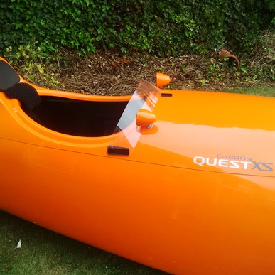

Post Options Post Options   Thanks (0) Thanks(0)   Quote AlanGoodman Quote  Post ReplyReply Direct Link To This Post Posted: 24 May 2017 at 10:45pm
The windshield is very much like the visor on a motorcycle helmet so I can just open it a little... That clears the mist pretty quickly once on the move and I can open it fully when I stop...

Post Options Post Options   Thanks (0) Thanks(0)   Quote AlanGoodman Quote  Post ReplyReply Direct Link To This Post Posted: 24 May 2017 at 10:48pm
I actually prefer to just use the little polycarbonate flyscreen...

I don't use the RaceKap much - Main problem is that there is no way to carry it inside the Quest so if you go out with it on then you're stuck with it... it was fine when I used it in very cold weather though... That's when it was most useful but I'd rather just wear a hat to be honest... The little screen deflects a surprising amount of the cold air over you and definitely increases speed...
The Quest is fine in all normal conditions.
I wouldn't intentionally attempt to ride it with a 45MPH crosswind... I think that might get a bit scary!
45MPH downhill is ridiculously easy though... Big smile
