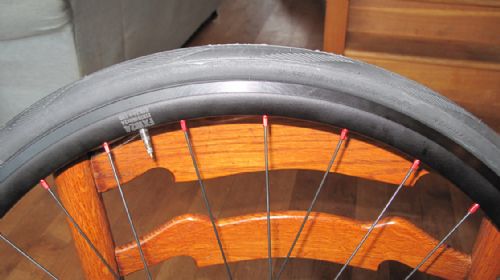

I've just put the 28-559 onto the new rim for the Great White and it was very hard. The most difficult part was getting the first bead onto the rim. Took two people and the Kool Mate with brute force. The second bead I managed on my own with the help of the Kool Mate but it is not as perfectly equally seated as I normally get. It looks to be about a couple of mm out at one point looking at what I take to be the seating mark on the tyre. Does anyone think it matters? I've had no success in reseating it. Just seems to take that position. It is so tight on the rim though I can't see it ever coming off.

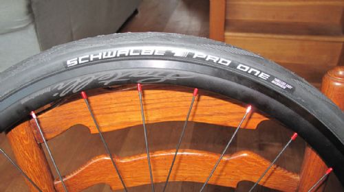

I just noticed that they tyre is equal on opposite sides but not all round. On both sides where there is the Pro 1 logo it is out and where there is no logo it is seated where I expected.

Yes, that's exactly the problem I was having. Result is enough of a bulge (5mm or so) that any power savings from the fast-rolling tyre are cancelled out by incessant ratting of the rider's BRANEZ/fillings/eyeballs/etc:

When a Durano is fitted, the moulding line below the logo is visible all the way round the tyre.

Thanks Kim. Looks to be in exactly the same place as mine as well. It's strange because my 28-540 fitted just fine and without issue with a tube.

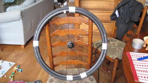

Kim, I have improved the fit somewhat by deflating then taping the bumps down and reflating the tyre. The idea being to push the tyre further down on the rim at that point when it's re-inflated. It's about 1.5 mm out of round now instead of 3 mm. I've ordered a Continental Grand Prix slick though to see how that fits. I notice it's a higher pressure tyre than the Pro 1 so it may have less rolling resistance.

Overnight the tyre has improved and is now 1 mm if that out and looks pretty well seated correctly.
